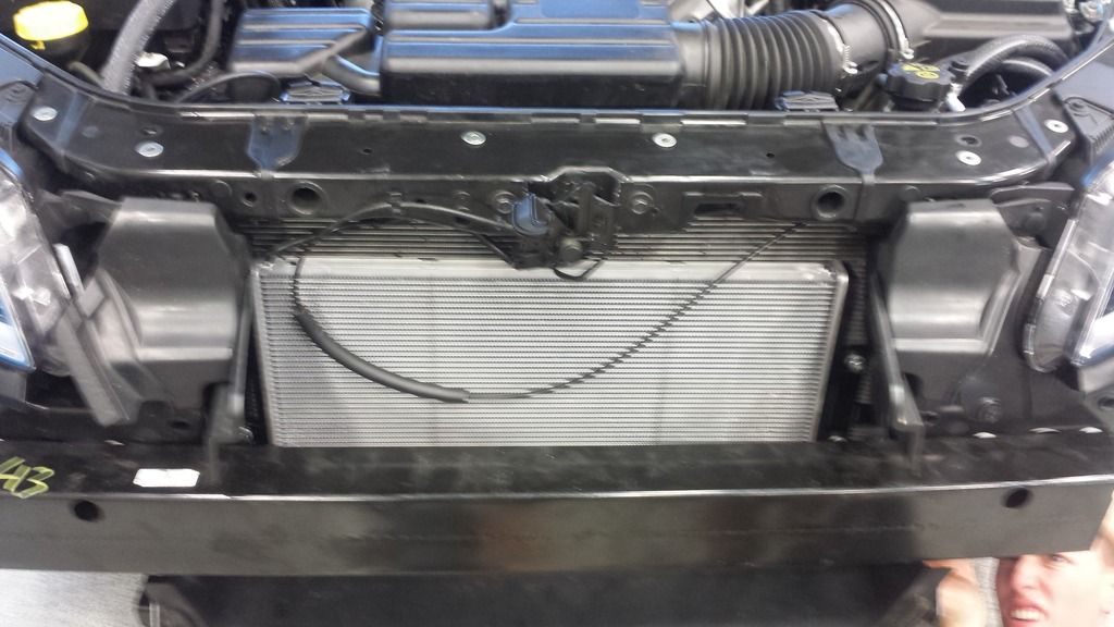

I removed the front bumper to see the space available for a heat exchanger. I haven't seen any detailed pictures on what people have done for heat exchangers, so if you have any, please post them up :)
I now understand why the washer reservoir is often relocated, although I think I can fit an exchanger without moving it.
The measurements are meant to show the general sizes, they are not very accurate - don't try to build off of them.
The rectangular black box behind the bumper bar That's the washer reservoir.
Width at the top.
Width of the bottom "mouth" it narrows significantly as you co back to the condenser
Height of the bottom "mouth"
Height to from the bumper br to the top
Total heights behind the reservoir
Space behind the reservoir

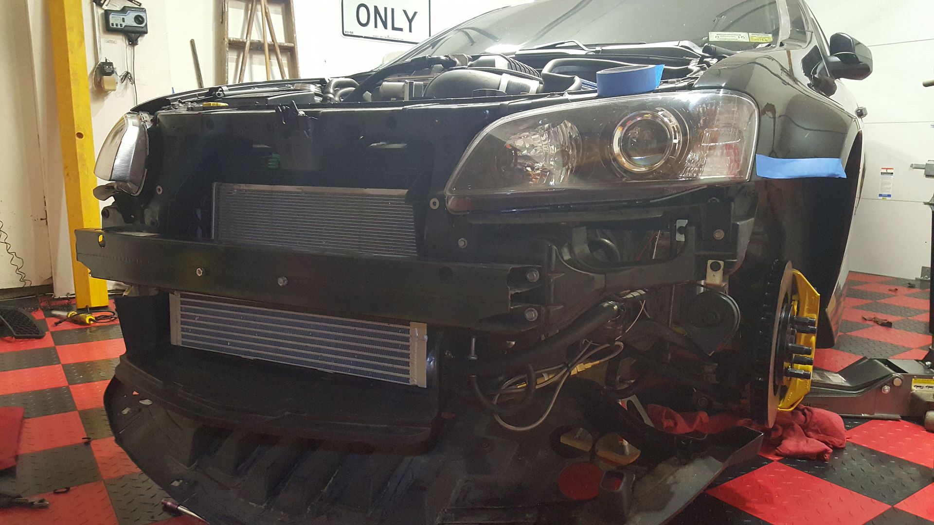

The air to water intercooler for my supercharger sits in front of the AC condenser. The kit used brackets to lean the whole stack of heat exchangers back at the top. This allows enough room for a full sized intercooler to fit without trying to occupy the space of the AC condenser. Leaning it back requires different intake plumbing, but that is pretty simple and doesn't require using an aftermarket airbox.

After seeing these pics the ve front is very similar. I am running a zl1 in conjunction with a frozen boost front. It is similar dimensions to the gt500 but is much more appealing. With the zl1 the washer res has to be relocated.

Yes the plastic is cut...that's up to you. I did want to keep the washer fluid reservoir in the stock location and the GT500 is almost completely in tact. I modified the original bracket to allow it to be bolted to the bumper, but that's all. Pump and bracket are stock and the HX is using all the original bolts.
