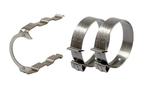

You can even make your own A/C hoses easily enough. Eaton EZ Clip hose and fittings work great. They provide for many standard and metric fittings. And if you have a unique fitting, they have a braze-on barb so you can use that fitting with their hose.
Now I definitely prefer stock parts when I can get them. But when they are no longer available you’ve got to be aware of the options.
