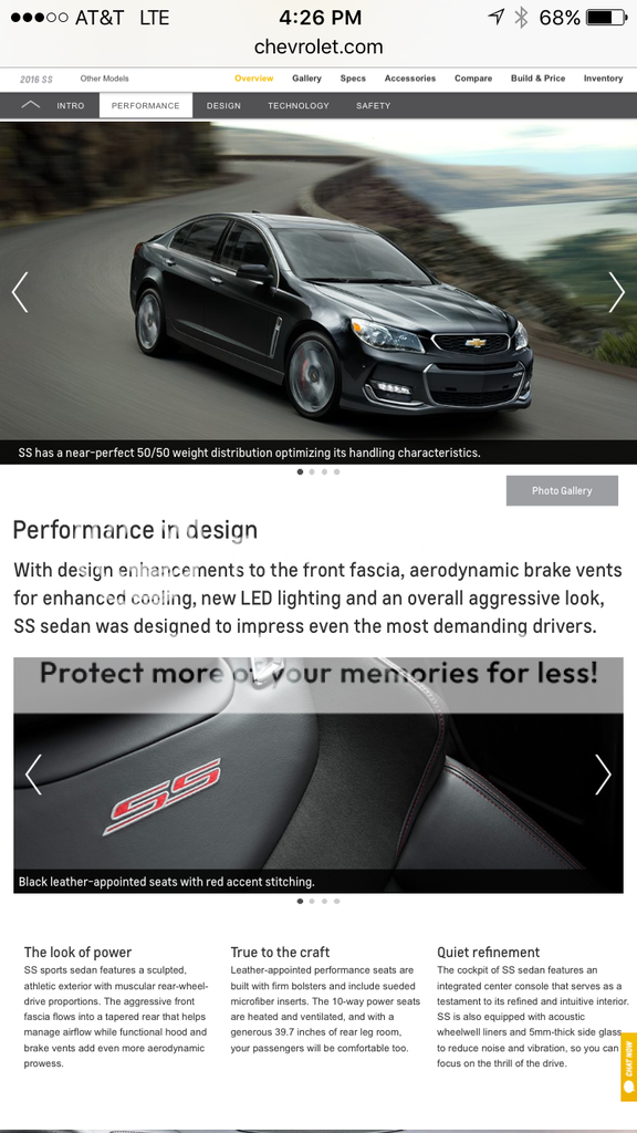

All great info until Chevy marketing un does it and adds more confusion with their description of the ducts on Chevrolet.com.
#3 ·
I recall either making a similar comment or that someone else had mentioned the same thing previously--yes, "Marketing" does not equate to any understanding of engineering. The average tire-kicker isn't likely to pay much attention--has to be frustrating for the effort to be put in to make changes like this and then see them bastardized by people who don't have a clue....
