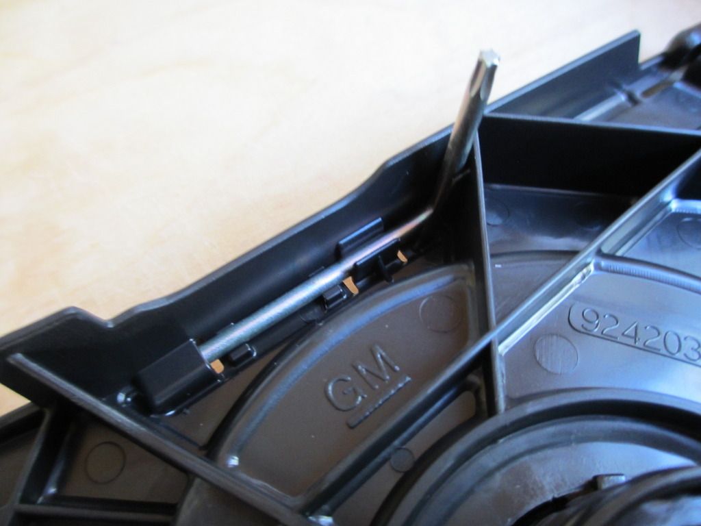

It's included on the inflator kit and jack kit for the SS and same for t5he G8, I believe. No mention of it in handbook or service manuals.

Crazy Paul says its for the lock screw on the TPMS sensors.

As much as I would like to confirm this tool is for the muffler bearings, I can not. Even though it would give some people satisfaction to have something to throw at an appropriate time, it is not for this either.
Drum roll please... The vehicle may have a torx tool for use when replacing the front headlamp bulbs. This is a headlamp tool for removing the screws in the inner fender to gain access to some of the bulbs.
I do not think it will provide you much assistance with your "manual sunroof" :D.
I hope I was able to help clear this up.

One more question about the "access" torx key. I see the one in the picture is on the top of the inflator kit, but if you have a full size spare, where is it located???

According to the parts diagram, it sits in about the same place on the jack kit.

Correct...you will need this tool or a Torx screw driver to remove the high/low/turn signal globes from under the wheel arch....the only globes you change from the engine bay are the parking lights.
It is easier to remove the wheel to gain access to the mudguard lining with the Torx tool.
I know as I upgraded the low beam light globes....I do not have the same lighting system as the SS....but is still the same procedure....on your drivers side in your SS and mine it says to remove the air cleaner element and the casing....that is BS.....you still have to gain access from under the mudguard lining....it is to difficult from the engine bay and bloody impossible.:smile
