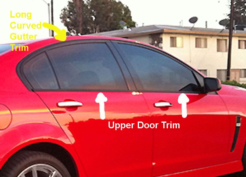

full Black side trim is now done! the top window trim was cake. the lower Trim... no so much!
now the door handles look out of place. i tired to remove these but they are NOT removed like the G8 ones. at least there is not a standard bolt that removes the handle. it is a torx bit and it looks totally different in the inside. i am a tad weary of removing it that way and think it might be better just to remove the door panel.

where did you get the trim from?
upper trim from a GMC dealer. ;) they uppers are the same as a G8 [correction... see below post]. the lower black trim i ordered from Australia from Crazy Paul.

618 Posts
2014 Chevy SS from factory has 6 "chrome" pieces surrounding the side windows.
The most cost effective way to change these 6 pieces to BLACK is to:
A) Buy the 2 replacement black really long curved gutter trims yourself from GM in USA. You don't want to be transporting them very far because due to their length and fragile nature the shipping is expensive and transit damage is common.
GM Part Numbers : 92294363 (left, black) 92294362 (right, black)
PLUS
B) Buy the 4 replacement black upper door straight trims from Australia.
(Much cheaper and can travel thru the Postal System).
I can help with B). Send me a PM or e-mail [email protected]
618 Posts
Further Info:
A) The GM packaging will normally be 1 long curved gutter trim per cardboard carton. Each carton is 90" x 20" x 3". If you collect these cartons yourself from a GM dealership you can fit both gutter trims inside the cabin of your car, if necessary.....then environmentally dispose of the cardboard cartons.
(Take some old towels & some tape to protect the interior of your car)
B) The straight upper door strips are only 41" long and travel thru the postal system from Australia & delivered to your house by USPS.

Discussion Starter · #12 ·
Further Info:
i have to get you a better photo then this. i took this photo in the Ghetto!
