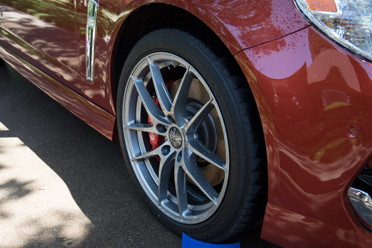

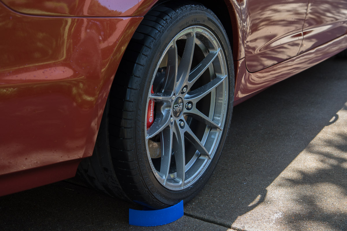

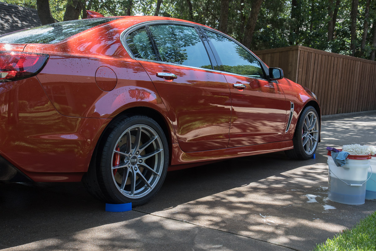

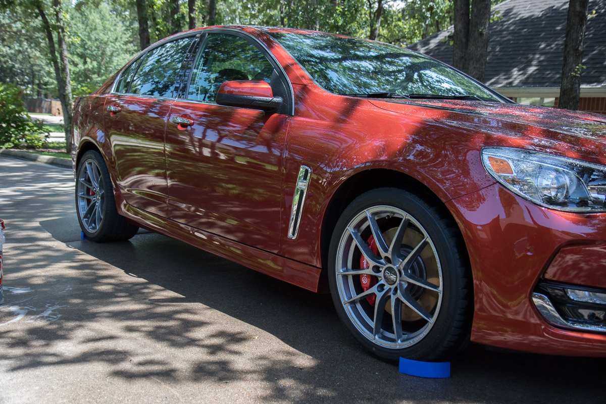

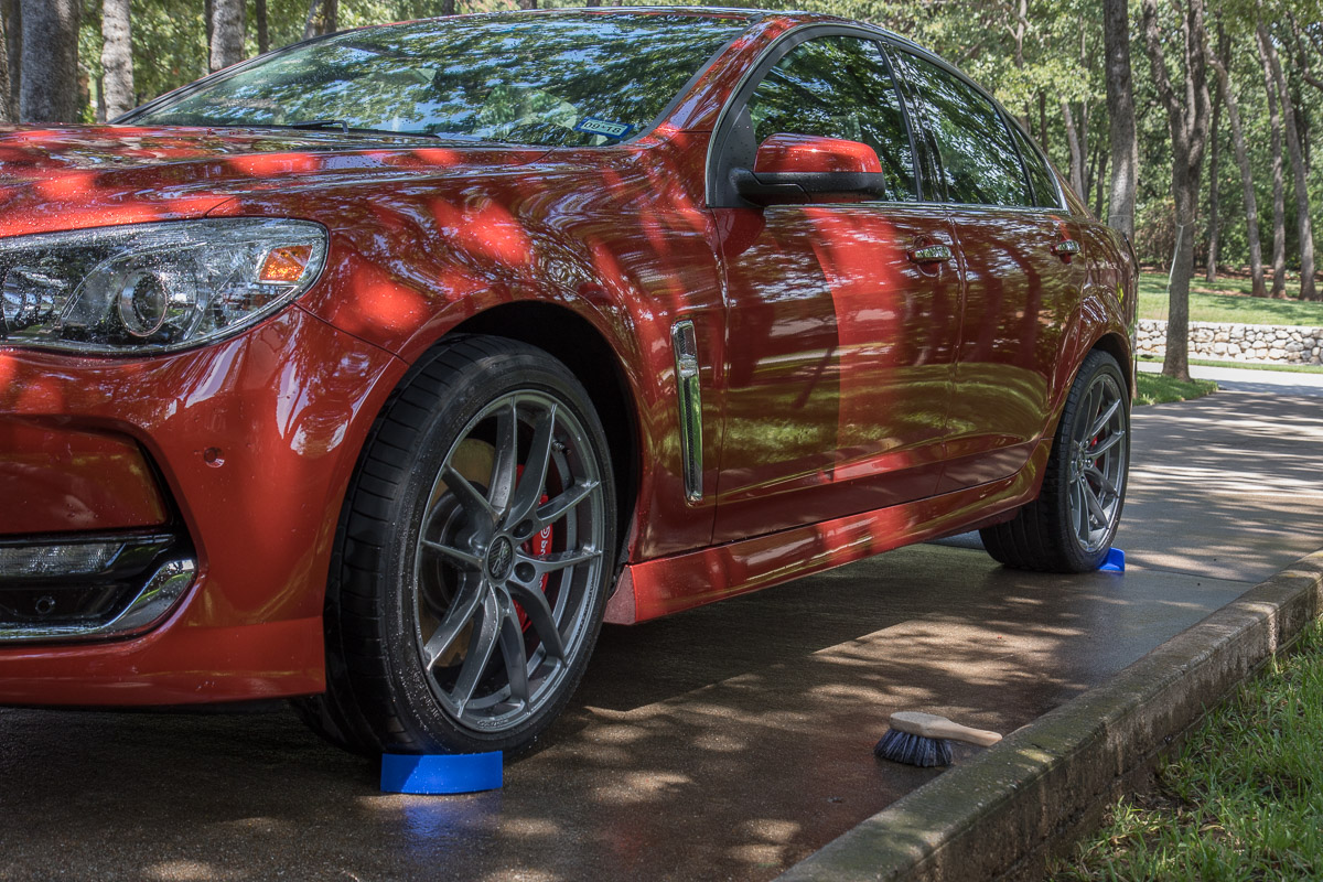

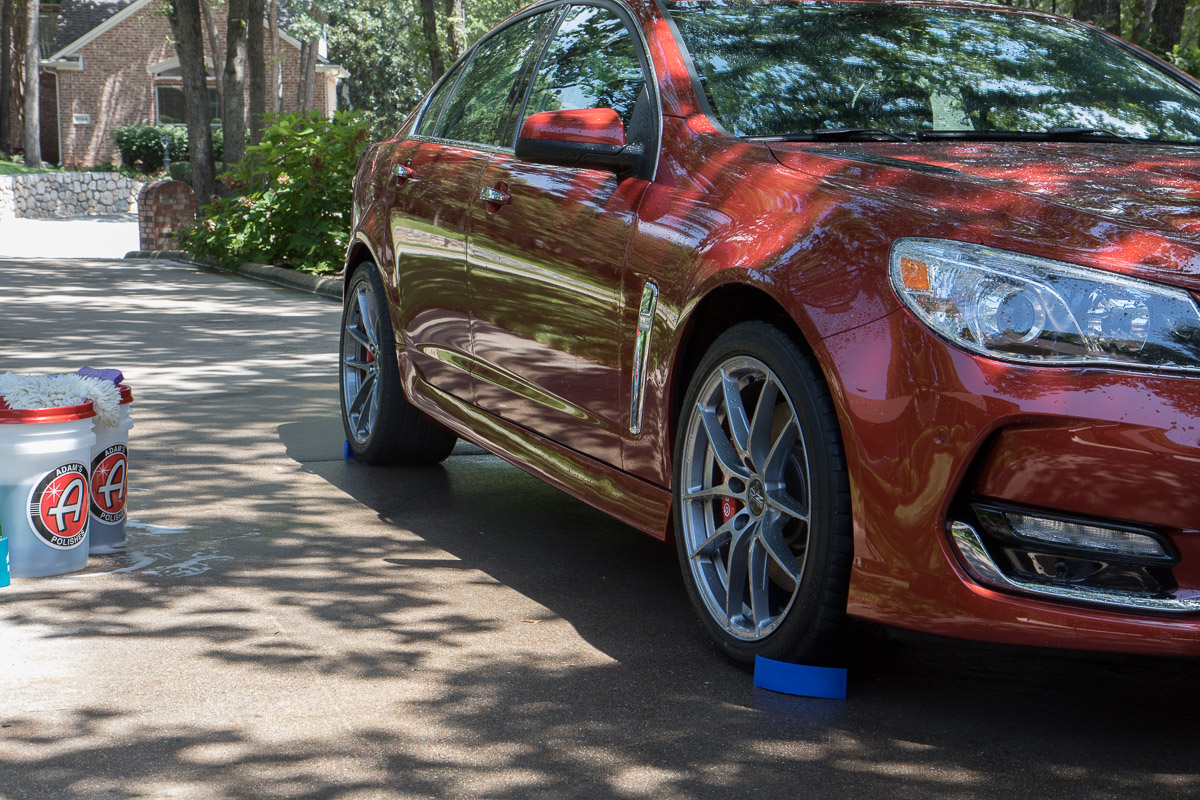

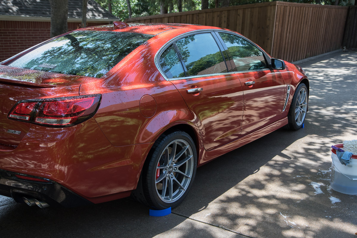

After much deliberation, I finally made a decision and put some new wheels on the SS. This post by @tanisdwninit pushed one of my top contenders over the top: The O•Z Leggera HLT, Bright Race Grey finish.
Today was bath day and while she was drying off a bit before getting her detail spray, I took a beer break and a few photos. They're not great shots, but they'll have to do for now.
The particulars:
Front: 19x8.5, Offset 35mm
Rear: 19x9.5, Offset 45mm
OE tires & suspension
I had intended to take some 'before and after' measurements to determine exactly how much the track width increased, and measure the exact weight differences. Alas, it didn't happen. The wheels were originally scheduled to arrive at my installer a week or so after we returned home from vacation. Much to my surprise, they arrived the day before we left. I rushed the car down to the installer without getting any measurements or weights. I picked it up, drove it about 20 miles or so round-trip for a lunch meeting with my accountant (they seemed to be perfectly balanced), then parked it before heading out for a 10-day road trip to Colorado. Whew!
The Rims & Tires online configurator shows that the fronts stick out 13mm more than stock, and the rears stick out 12mm more than stock. Well within the acceptable range for my tastes. I have no plans to lower the car.
They fit perfectly and required no spacers, though the rears are mighty close to the brake calipers. They did require centering rings and new lug nuts, but those were included (and the centering rings pre-installed) in the quoted price from Tire Rack -- along with a pair of thin-wall sockets for use with the new lug nuts. Nice!
Overall, I couldn't be more pleased. I really like the style of the wheel, and the finish is in the Goldilocks zone for me: not too dark, and not too bright. This is my first wheel purchase from Tire Rack, and it went very smoothly. Also, Kudos to Firm Automotive on NE 28th St. in Fort Worth (my preferred installer). We've been dealing with the Firm family for years, and they always do a great job -- no surprise to have discovered so many 5-star reviews for them on Tire Rack's website.

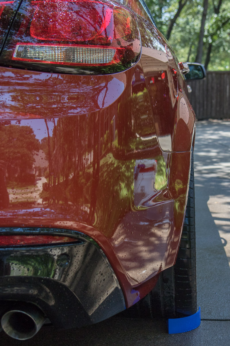

Well, I thought it was my imagination the first time it happened. But then it happened again. I'm getting a slight rub of the passenger-side rear tire on the inner fender lip with both kids (under 100 lbs. each) in back when going over a bump/dip at moderate speeds. I looked this morning and sure enough, there's a small area at about 10:00 with no paint. :frown

It's not major, but it's undeniable. Given everything I've read here about the various wheel/tire/suspension combinations, I'm quite surprised. But... it is what it is. I feel sure that some minor re-shaping of the finder lip in that one area will prevent any further rubbing. I'm not thrilled about it but not losing any sleep over it, either.
