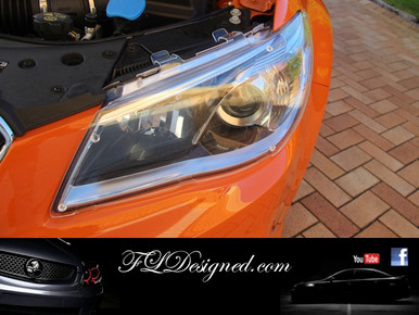

I tend to keep my cars. Right now, I see a 10 year plus time horizon for my 2015 SS. Since I keep them a long time, I like to take steps to protect the car from the beginning. I did this with my last car I kept 12 years and it looked great when I finally sold it. It was so clean I got better than dealer retail price with multiple competing buyers.
One of the things I did on that car I'd like to repeat was protection for the headlights. If you look around you will see that modern plastic headlights gets pitted and discolored over time. Looks pretty bad by the time a car is 10 years old, especially if that car was left outside. Mine will be garaged, to prevent the discoloring of the plastic, but road debris will still cause pitting, especially in the winter with sand on the roads.
On the last car I used lamin-x headlight protectors which are thick clear bra material on the headlights that is precut to fit. I did it myself and it didn't come out perfect. The SS headlights are actually a quite complex shape as they bend to the sides, so for the SS lamin-x rates the install difficulty as 4 out of 5. I don't want to try this again as I want perfect.
2 options:
1st:
The shop that did my clear bra will do the headlights with the same clear bra material (3m scotchgard pro) for $120 for both lights. They did a great job on the clear bra, so I'm confident they would get it right
2nd:
fl designs in AU makes plastic headlight covers. Look decent. About $120 shipped to the US. Would likely trap water underneath requiring occasional removal and cleaning. I would expect much better impact protection at the expense of not looking as good. There is a holden accessory too, but to me they look awful, so I won't bother with those
I'm leaning toward having the local shop wrap the lights. Not as good protection from big impacts, but should prevent the pitting and is basically invisible. Thoughts or experience with these products?
Here is the URL to the FL designs clear covers:
Holden Vf Clear headlight Protectors - FL Designed

So I got the lights wrapped. They used llumar film which is what they use on everything. This shop is right near many car dealers and does the work for Chevrolet, Subaru, Mercedes, Porsche, dodge, audi, etc. They are the ones that did the work on my SS for the chevy dealer as part of my purchase back in march. They did an excellent job so I went back to them.
They did both headlights for $80. They looked at the lights and the installer said they couldn't do the whole light because of the complex curve that feels like a ridge on the side of the lights. He said the film would lift eventually. I asked if they could do it in 2 parts, placing the seam right on that ridge. He agreed. Took the installer about 45 minutes to do both lights while I waited. It almost impossible to see the seam and the entire light is covered. I'm quite pleased with the result. Here is a picture with the seam pointed out. Work is warrantied for 5 years.
