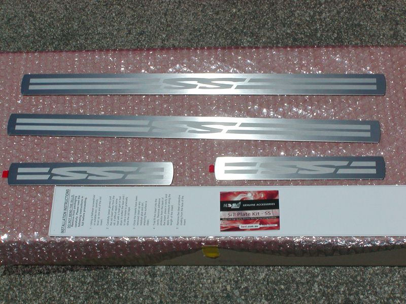

Holden Lion Stainless Steel Sill Plates
Bought these from CrazyPaul almost two months ago and just got around to installation today. I'm really happy with the results. The trim tools pictured earlier in this thread came in handy, but I didn't use them to pry out the old sills. I utilized the trim tools to carefully lift the sills. It's important to slowly "lift" the sills, and not attempt to pry them out. Let heat soften the adhesive. I didn't use a heat gun, as I let the southwest Florida sun work its magic.
If you're thinking about doing this modification, exercise patience, take your time, and let the heat gun or sun soften the adhesive. The old sills can be slowly lifted away as the adhesive softens and releases.
FYI, the new sill plates have the Holden Lion on the fronts only.
Cheers

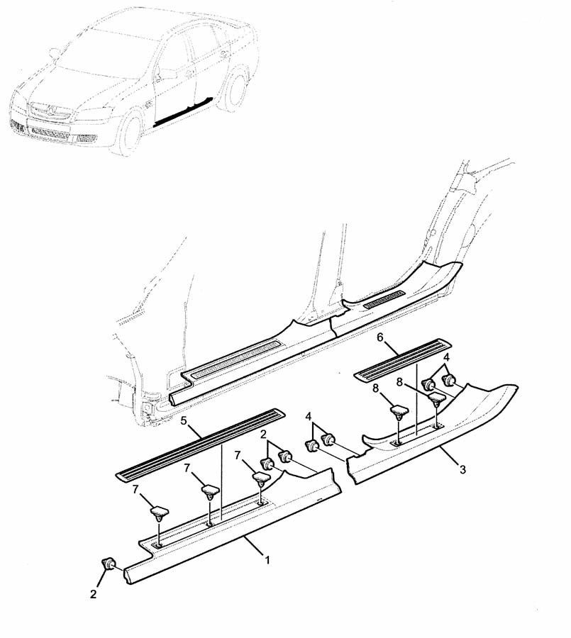

I understand this an old thread post, but can anyone tell me whats the part numbers for #7 and #8 clips are? Thank you!
Sent from my iPhone using Tapatalk
Thank you. I missed that somehow when searching that parts site.
