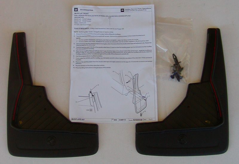

Here's a copy and paste of the info:

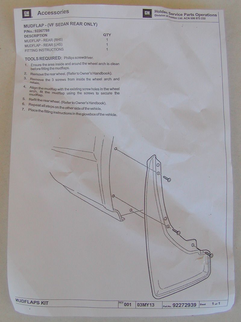

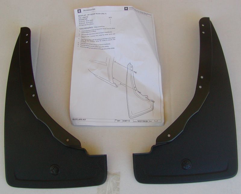

Set of 4 front and rear molded mudflaps to suit 2014 Chevy SS.
Each flap has a small Holden logo.
Fasteners and Instructions are included.
Total shipped for the set of 4
US$135 shipped.
Please pay as normal "goods and services" to Paypal ID = pjsadl[email protected]
ETA 10-14 days.
Just a note, the large lip on the front flaps is quite noticeable on light color cars. I used my dremmel to cut it down on my silver G8.

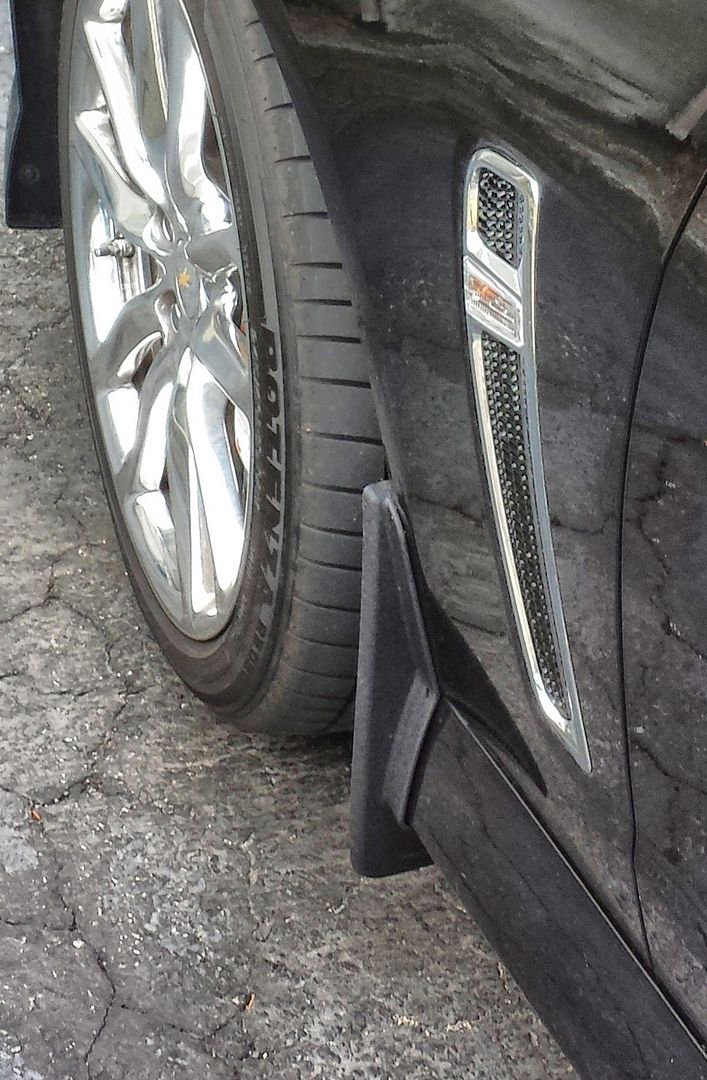

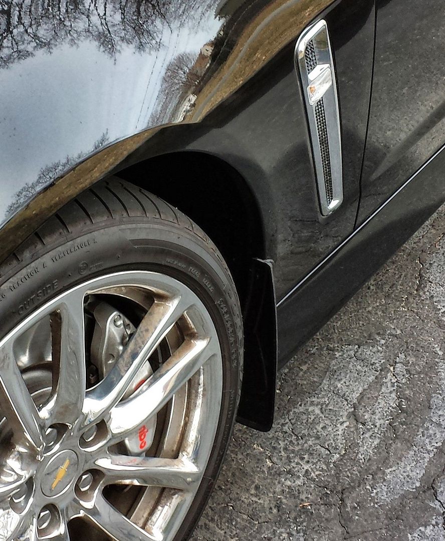

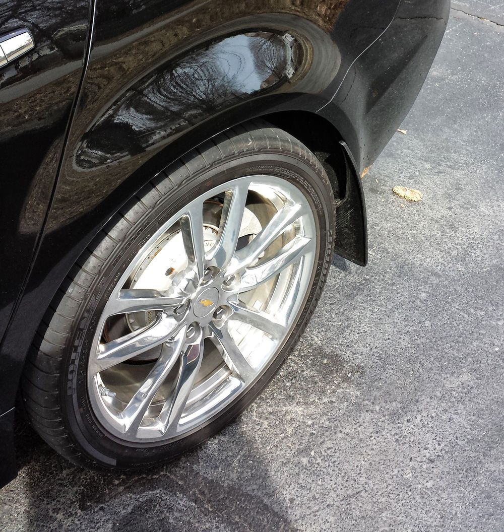

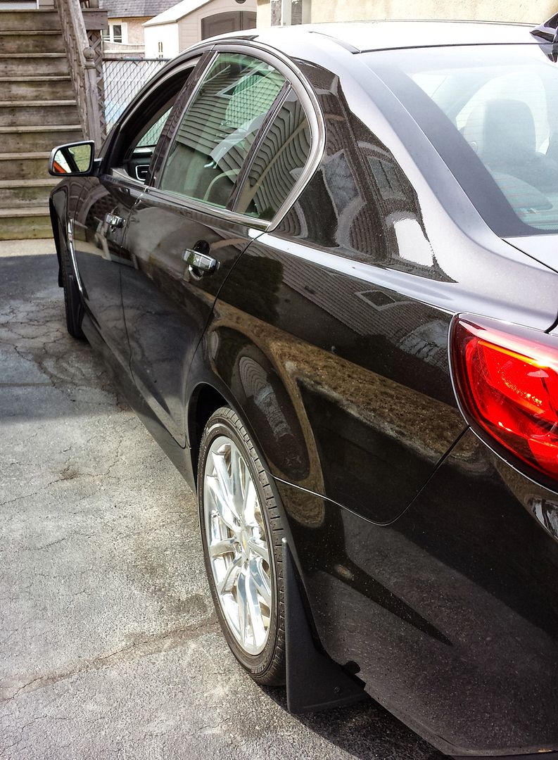

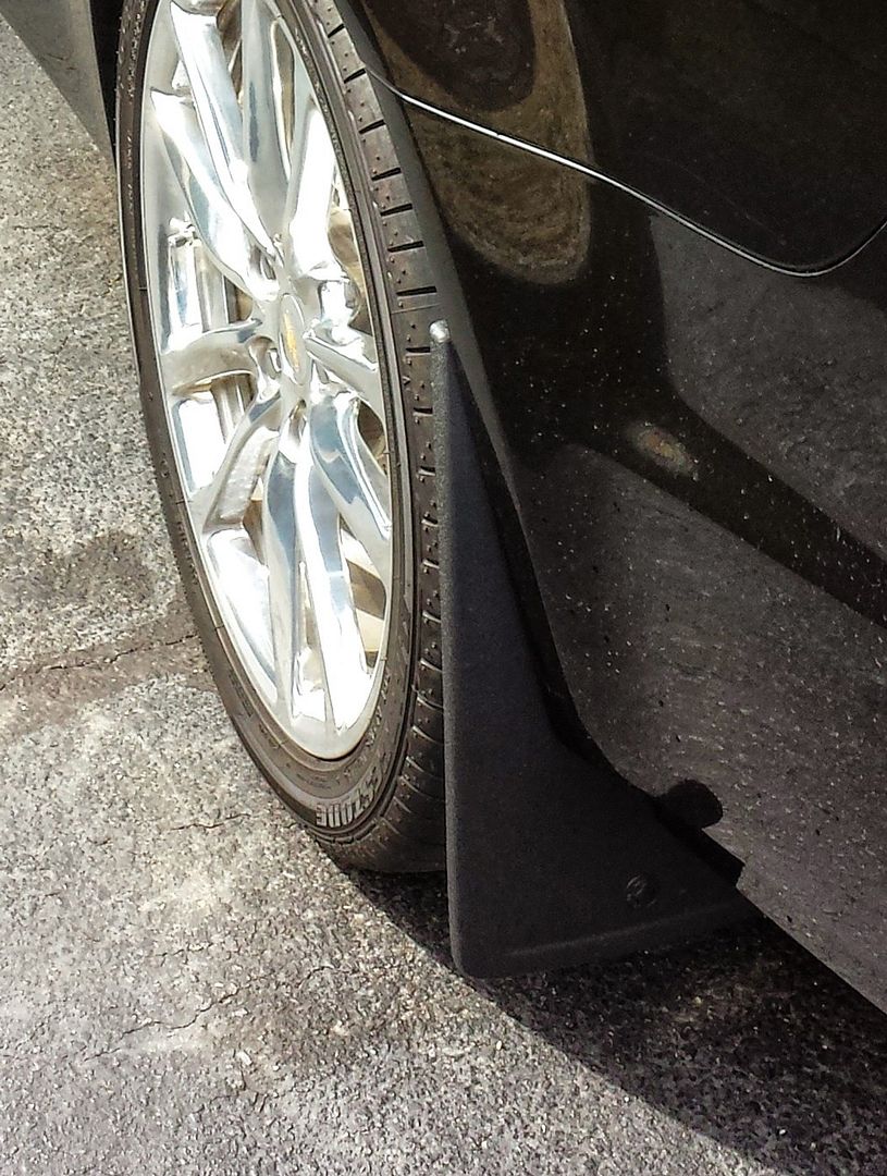

I just put my rears on. NBD and don't have to remove the wheels if you use a short torx bit, 1/4" socket for the bit and a small 1/4" drive ratchet.
I'll get pics later its getting dark but I noticed immediately that the right side when standing behind the car and eyeballing the flap on the tire tread sticks out further to the right than the left sticks out to the left.
Yes they are on right they kinda go on only one way with minuscule play in the holes.
Sighting the bottom of the bumper cover on the tire treads now that I pay attention to it I immediately noticed there is a variance left to right in the cover profile. At the bottom the right sticks out further than the left!
The cover itself lines up fine with the body and was not damaged or scraped underneath.
Anybody else have or catch this?
It's not a huge deal, nobody will notice it but I do!
