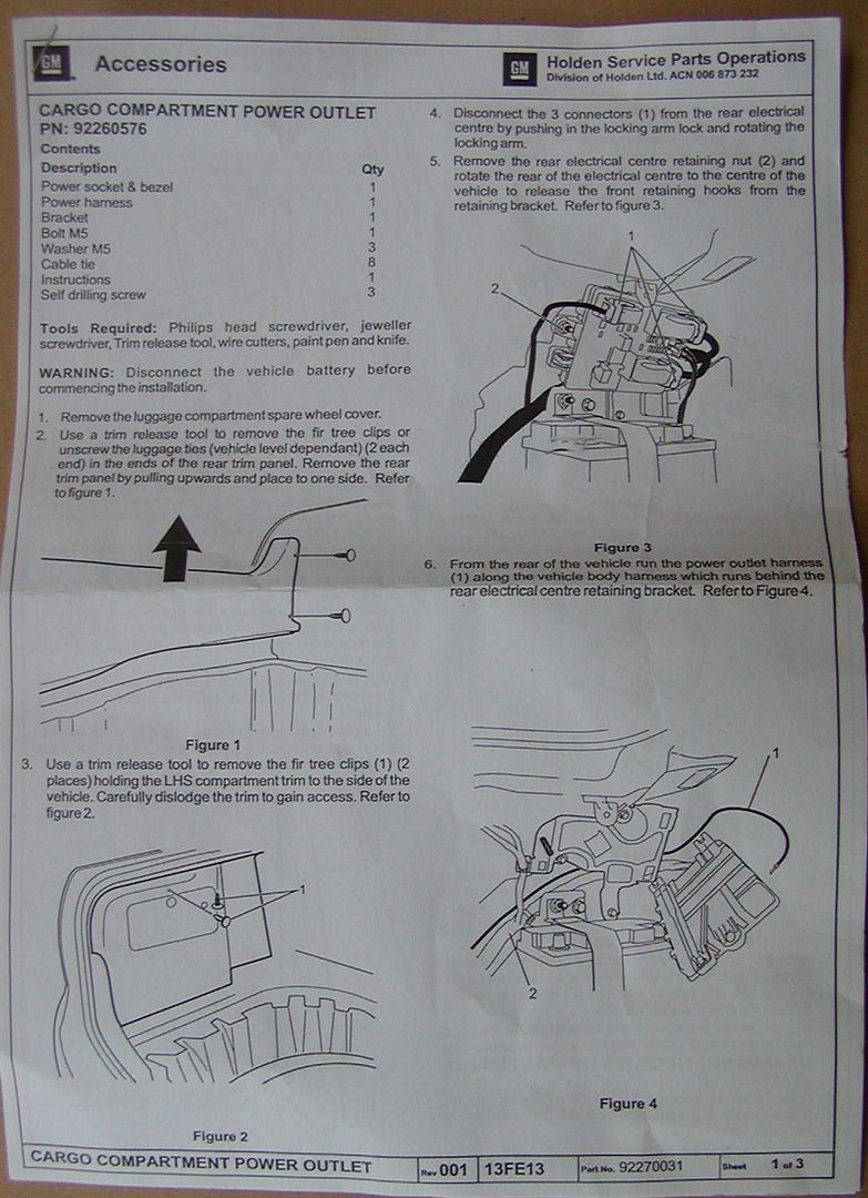

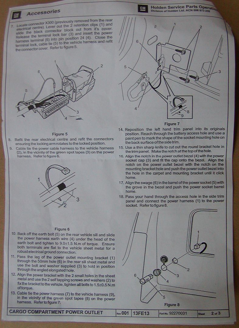

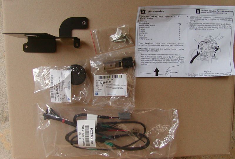

All..This accesssory is Holden/GM part from CP, so I had my local dealership GM Tech install which took approx 1 hr labor..worth it for sure! Many uses for home and the race track!:)

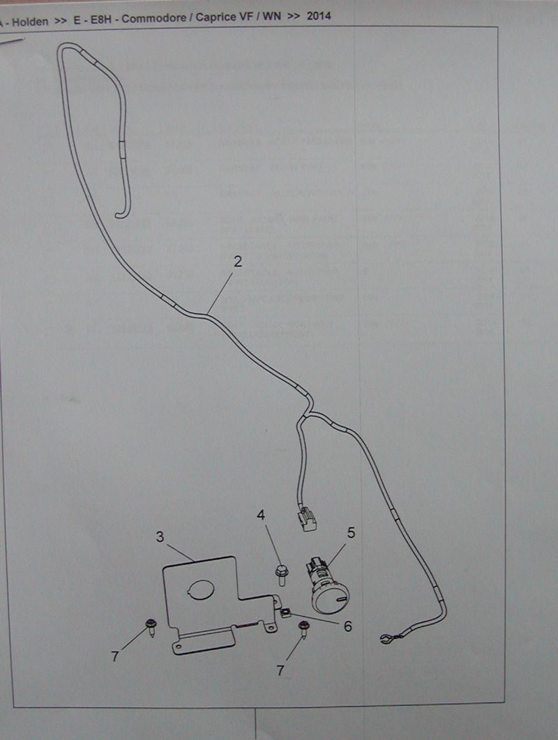

I have added this to my SS as well. While the bracket is made to be bolted/screwed into existing points, as long as you watch the thickness of where you want to mount this and modify the bracket accordingly, I do not see why you could not use it elsewhere. Might be better to use the wiring harness as a starting point and then purchase a 12V port that can accommodate different panel thicknesses better.
