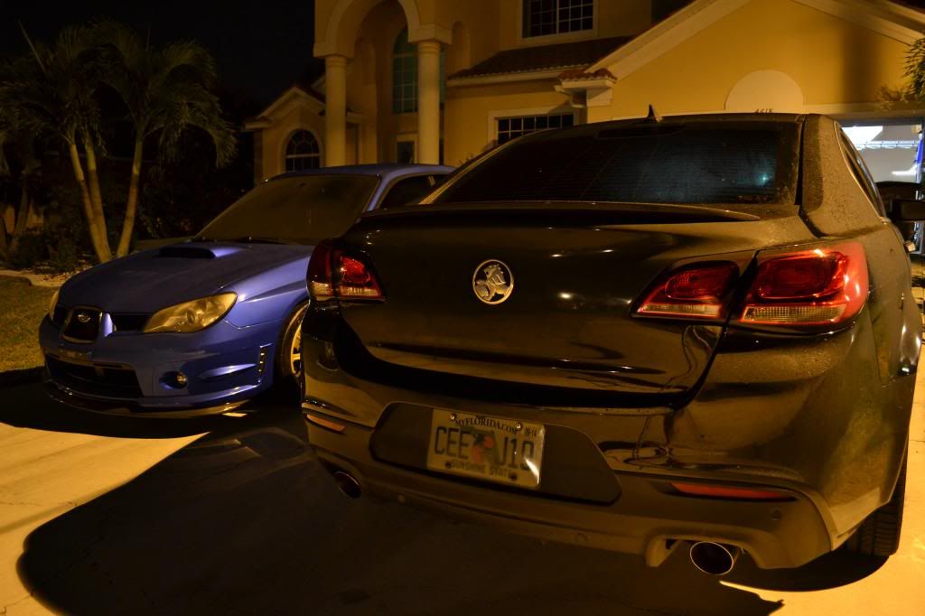

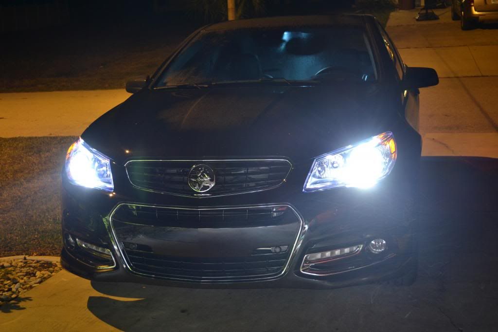

My Holden parts from Crazy Paul showed up today, I wasted no time to get them installed. Now I'll be driving my car much more, I held off on driving it until the conversion was complete. I also changed out my HID bulbs for 5000k and raised the headlight aim slightly to improve visibility. This was pretty common on GTOs.
The pictures aren't the greatest since it's dark outside and the car is covered in condensation. I didn't get any 50/50 shots of the new low beams, but these bulbs are a nice pure white versus the slightly yellow stockers. Now I just need to wire the LED running lights to be on all the time and await Mav Man's LED fogs. I also never posted about it, but I had my windows tinted - 20% all around plus 70% windshield.

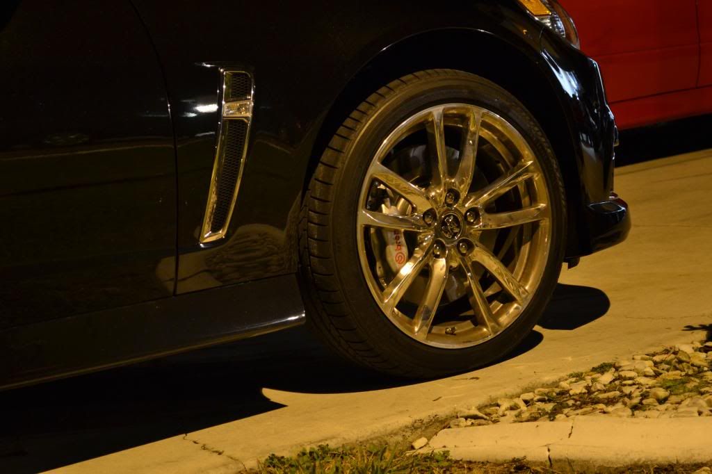

Also here is a random picture I took while doing the work.

5ks look good. I need to stop being lazy and put mine in.
I slightly wish I went with 6000k since I always like that temperature due to the bluish tint; however the pure white from 5000k will match the running lights better.
In my opinion you have to remove the bumper and headlights to change the bulbs. My brother and I tried to change it from inside the fender with the wheel off and it's just a really tight squeeze. There are two screws that hold the metal housing onto the bulb that need to be removed along with the bulb harness.
Headlight removal was straight forward itself, just do some looking around and you'll find all the fasteners. The driver side does have a few hidden bolts behind plastic trim that needs to be removed.
Hmm. I figured it wouldn't be too bad with the front wheels off. I pulled the driver side bulb with tire on just to find out what kind of build it was and it took a mirror, a magnet, and a second set of hands to them stupid screws started.
Yeah it can be done, but it'll be a huge PITA since it's a tight space to work in. If you are doing a Holden conversion and have your front bumper off it'll be easier to just take off the headlights and change the bulbs that way. If you aren't taking off your bumper then just go ahead and do it from behind since taking off the bumper/lights is a lot of extra effort.
