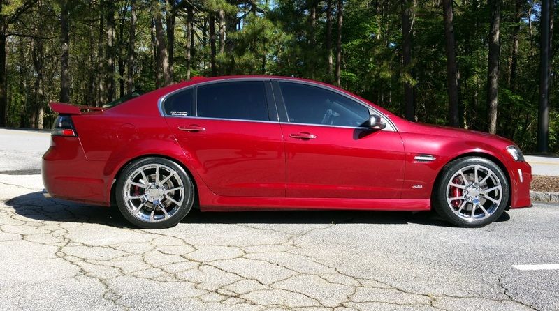

I know some people where looking for these pics - I through on my set of V2 rims that I have laying around - sorry for the rainy pics but the weather sucked her last weekend - they fit with no issue.
TPMS - haven't driven the car to know if they work or not. I know the part numbers are different.
Nice! I need a set of those for my GXP.

put some lowering springs on her and itll look ****! Im gonna have to start looking for some black V2 wheels now..... that or some ZL1 replicas in black with machined face.... decisions decisions.....
