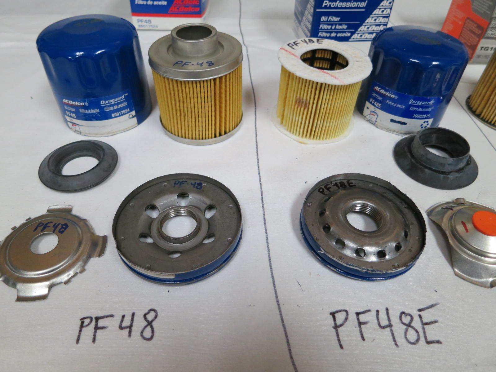

Stop using the PF48e, those are trash. Plastic core, fiber endcaps on the filter, cheap components top to bottom. I'm pretty sure it turned out to be a FRAM produced junk-tier filter. All ACDelco "e" branded oil filters are plastic core garbage.
I get UPF48R filters from Amazon, which are rebadged Mobil 1 extended performance filters. The decent quality standard PF48 became super scarce and hard to find back in the early 2010s when I used them in my previous 2009 Malibu. GM listed the PF48e as interchangeable and I noticed the quality was not the same, then I found threads explaining the difference on bobistheoilguy. Basically everyone hates them.

I'm a big fan of the Mobil 1 and Wix oil filters. I'll certainly consider using the UPF48R going forward, but as I stated in the video I used the PF48e to match what was supplied on the engine from the factory.
If there is still an active warranty and any time you deviate from what was used by the car manufacturer (no matter if the part if better than the original) and something happens to the engine, the manufacturer will call into question anything that deviated from the factory supplied parts. Even with the "Magnuson-Moss Warranty Act", it doesn't prevent the manufacturer from making your life more difficult when pursuing a warranty claim.
I say, if you are comfortable with using a different (and hopefully better) part on your vehicle, go for it! Just make sure you keep good documentation of your maintenance tasks (no matter what parts you use).

The UPF48R is an ACDelco factory replacement equivalent for the PF48 and it has been standard factory equipment on previous LS3 models. It will not void any part of your powertrain warranty.

Ive had the Chevrolet Dealer up-install the UPF48R filter both times. (aka gold letter) Its a black filter actually. I bought 3 on Amazon and did look down the bore of each of them...... not impressed with what looks like an ill fitting black ring down deep inside of it. All 3 look about the same when it comes to (not) seeing that ring around the whole inner circumference. I didnt cut one up. threw 2 in the SS trunk as loaners / spares and kept one in the garage. They really are not that much more $$ than the 48E
Normally I would also consider putting this UP48R filter in my 08 5.3 iron block Vortec LS with AFM. ....some concerns that the AFM (DOD) engines have different oil pumps or pressures and that the R filter may be a bit difficult for the pump to manage as oil pressure on the 5.3 can wane down to 22PSI when the oil gets some miles on it.
UPF48R (VS PF48) has a finer particle screen. (any proof?) Also heard it has a higher burst pressure. (any proof?) Its "made for" synthetic oil. (any proof...)?? Ooh, its seal is coated to come off easier (any proof)?? AND its also more expensive. (fact!) .
I think you can substitute with a comparable WIX and be just fine. or M1
